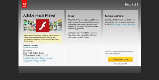

I am running Ubuntu 14.10 and I am trying to get the latest version of Adobe Flash Player for Linux (which apparently is 11.2), I am selecting the option for APT for Ubuntu 10.04+ here:
Adobe Flash Player Download page
But when I click the Launch Application button after hitting the Download button:

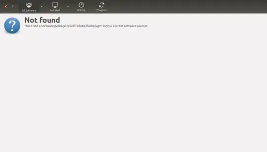

I just get this in the Ubuntu Software Center: Ubuntu Software Center Adobe Flash Player Not Found
So my main questions are, why is this happening? Can I fix this? And how can I get the latest version of Adobe Flash Player if I can't fix this?

  1. Make sure you have the Universe repository enabled (in Software Sources, accessible from Software Center -> Edit -> Software Sources, or sudo add-apt-repository universe or see How do I enable the "Universe" repository? ).
    1a. And just in case the adobe-flashplugin package is missing, you may not have the "Canonical Parter" repo activated in Software & Updates / Software Sources, see Ubuntu's help page for 14.04 trusty or 16.04 xenial.
  2. Update package index files (run sudo apt-get update ).
Mozilla, Firefox - NPAPI (Extended Support Release)
  • Note that the about Adobe Flash Player page says the "Linux - Mozilla, Firefox - NPAPI (Extended Support Release)" version is apparently not being updated past 11.2.x for Linux (& Solaris).
In this case, it looks like yours only launching the Software Center, and maybe doing a strange search that doesn't get any results.
I'd run apt-cache in a terminal, and search for adobe-flashplugin or flashplugin-installer (or just flashplugin).
I've got adobe-flashplugin installed, but there's several "adobe flashplugin" packages available, trying to install a different one wants to remove this one first. I think adobe-flashplugin is the version you'd want, apparently from these Q's What's the difference between flashplugin-installer and adobe-flashplugin? and flashplugin-installer vs. flashplugin-nonfree vs. adobe-flashplugin the difference is:
  • flashplugin-installer - extracts the 32-bit Flash player, and installs a 32-bit compatibility layer for 64-bit systems.
  • adobe-flashplugin 32-bit or 64-bit version, depending on your system
This search should find all that're available (and also the pepperflash plugin mentined below):
apt-cache search flashplugin
Then you should be able to install with this:
sudo apt-get install adobe-flashplugin
(Or if you wanted the other one, sudo apt-get install flashplugin-installer)
