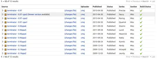

If you check the ppa page, you'll notice that there's no package version available for trusty (14.04):
But you can install the terminator package from the Ubuntu universe repository:
