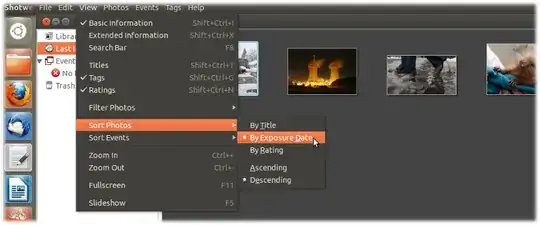

Shotwell
Shotwell Photo Manager is installed by default and can sort images according to their EXIF data:
