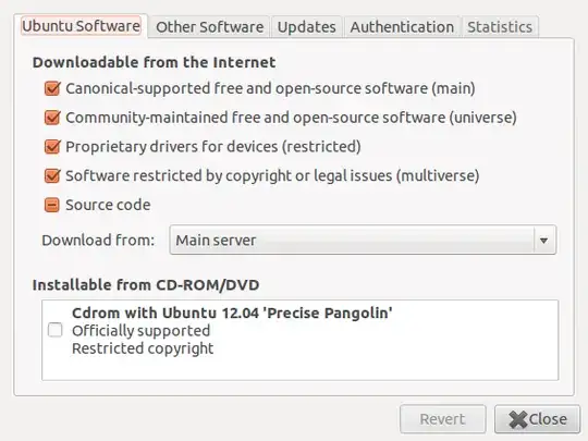

Open Ubuntu Software Centre, then on the top system bar select Edit and then select Software Sources. Next tick the boxes next to universe & multiverse, enter your password and click okay.
