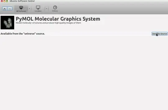

I think that you can install it via Software Center(GUI tool). As following steps.
Or If you use the command that "apt-get install pymol", first you must use following command:
sudo add-apt-repository "deb http://archive.ubuntu.com/ubuntu $(lsb_release -sc) universe"
