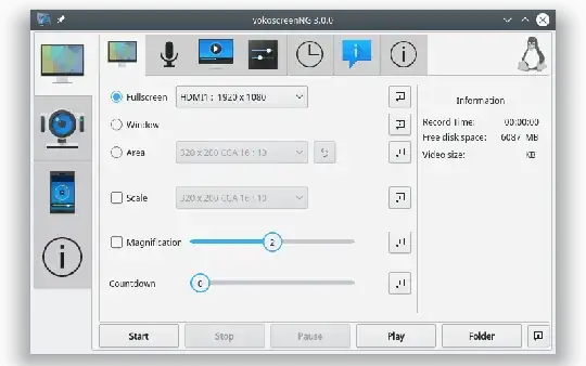

VokoscreenNG offers an option to record a window:
You can install it as a snap package by running the following command in Terminal
snap install vokoscreen-ng
You can also install it with apt on Ubuntu 20.04 and later from the universe repo by running
sudo apt install vokoscreen-ng
