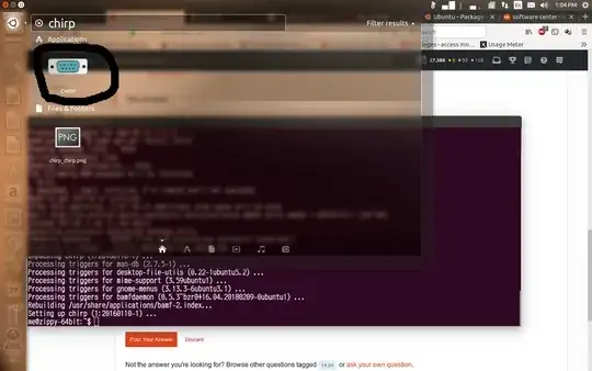

Then launch either via the Chirp icon in your application launcher:
Or via terminal with the command: chirpw
