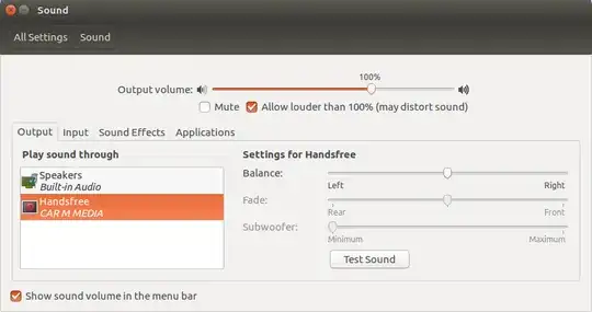

  9. In Sound settings I select "Handsfree CAR M_MEDIA" in "Play sound through" list. Sound settings
