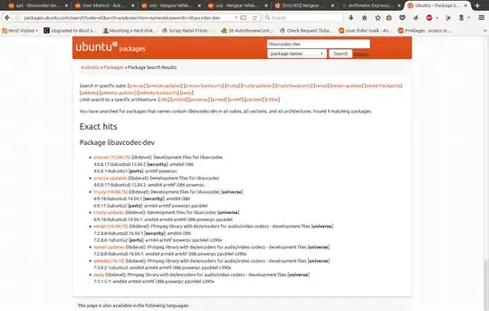

That package is available for all currently supported versions of Ubuntu in the Universe repository when in doubt use Ubuntu Package Search to not only verify a packages existence but also determine which repository it is in. Here's an example:
