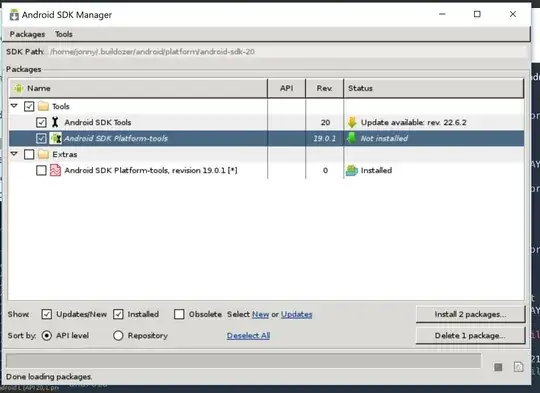

Then if you still get an issue, try running the android SDK Manager GUI and manually installing the dependencies:
~/.buildozer/android/platform/android-sdk-20/tools/android
Replace android-sdk-20 with your version
Then I had to delete the OLD version first, and then reinstall a later version of the SDK and rerun it
