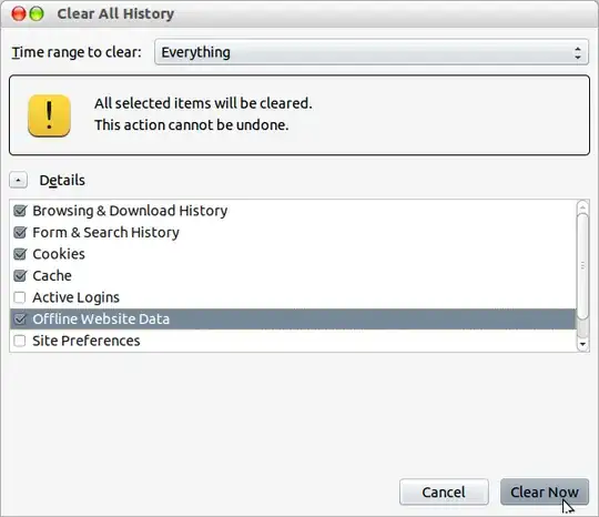

If it's just the browsers, you should look to clean up the cache, history, offline data, and other stuffs. The browsers offer such functionality, like for e.g. in firefox you can press Ctrl+Alt+Delete (or from menu History -> Clear Recent History...) to get the Clear All History window where you can select the things you want to delete and apply the action. You can do similar for the other browsers manually. Or you can try the tools that will handle these cleanups for you.
