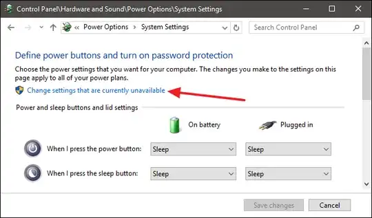

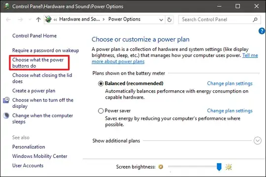

For Windows 8+
You need to disable the "Fast Startup" feature. To quote the How-To-Geek:
Open up your power options by hitting Windows+X or right-clicking your Start menu and selecting Power Options. In the Power Options window, click “Choose what the power buttons do.”

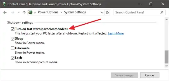

If this is the first time you’ve messed with these settings, you’ll need click “Change settings that are currently unavailable” to make the Fast Startup option available for configuration.
Scroll to the bottom of the window and you should see “Turn on fast startup (recommended)"
Uncheck the "fast startup" box.
Then, shut down Windows 10, and you should be able to mount the NTFS partition from Ubuntu just fine.

Windows 10 and Windows 8 both act funny about shutting down. Delete the fast boot option in Windows and if using Windows ten, make sure you reinstall the home option, which looks like a house, from Windows 8.. Then use it to shut down, not restart, when you want to go into Linux, or the error will continue to pop up, and when in Linux you cannot access the one drive... Or more than one Windows drive on my system... As I have one drive I use for sharing files between Linux and Windows.
