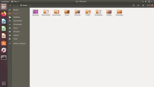

Here is a screenshot of my Files window:
Screenshot of Files window
I am unable to see my HDD. Please help.
