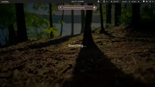

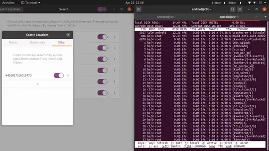

My files are in NTFS drive 4416017316016770 which is automount on bootup. No files however is shown during gnome search from my NTFS drive. Although lot of crawling work of tracker has gone for hours now.
android@clr:~
$ lsblk
NAME   MAJ:MIN RM   SIZE RO TYPE MOUNTPOINT
sda      8:0    0 465.8G  0 disk
├─sda1   8:1    0   292M  0 part /boot/efi
├─sda2   8:2    0   512M  0 part [SWAP]
├─sda3   8:3    0 108.6G  0 part /
├─sda4   8:4    0    16M  0 part
├─sda5   8:5    0    79G  0 part
└─sda6   8:6    0 277.4G  0 part /media/4416017316016770
sr0     11:0    1  1024M  0 rom
4416017316016770 contains common directory for me (linux+ windows dual boot)
i have full read/write access to that partition.

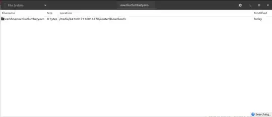

CATFISH SEARCH enter image description here
i want verkhnenovokutlumbetyevo to be shown on gnome activities search.
i mounted the volume now to home itself.. still gnome search not working.

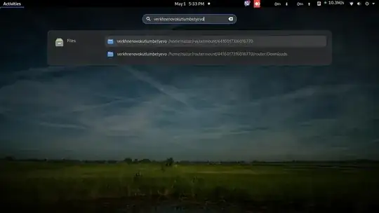

FINALLY SOLVED . THANKS TO POST BELOW IN ANSWER
nazar2sfive
  • 1,493
To have tracker index a directory that is not included in its default list, you have to take several actions. I have just managed to have indexed a mounted windows partition, which was previously not indexed, so the description below worked for me.
I took several actions, and some of them may be redundant. It would take some more trial and error to find the exact combination/s that produce the intended results. But this configuration (perhaps "in excess") would work.
  1. Add a bind mount as explained here (also linked in another answer). Assume the mount is in $HOME/mount_dir. It will point to the same directory as /media/4416017316016770 (in my case, /mnt/windows). The fact that you see it twice in catfish probably means the binding is ok. Note that this mentions a soft link instead of a mount should work. I didn't try it.
  2. Add directory /media/4416017316016770 in gsettings org.freedesktop.Tracker.Miner.Files index-recursive-directories. You could use dconf-editor (install it if you don't have it), navigate to org.freedesktop.Tracker.Miner.Files, and modify key index-recursive-directories. My current value is ['&DESKTOP', '&DOCUMENTS', '&DOWNLOAD', '&MUSIC', '&PICTURES', '&VIDEOS', '/mnt/windows', '/bin'] (I have added also /bin to test the difference between adding a directory in the same drive and a different drive).
  3. Add directories /media/4416017316016770 and $HOME/mount_dir in key org.freedesktop.Tracker.Miner.Files index-single-directories. My current value is ['$HOME', '/mnt/windows', '$HOME/mount_dir'].
  4. Set org.freedesktop.Tracker.Miner.Files index-removable-devices to True.
  5. Stop and start the daemons.
$ tracker daemon -t
$ tracker daemon -s
  1. Make sure indexing finished with
$ tracker daemon -f
  1. Check if your file is indexed with
$ tracker search "verkhnenovokutlumbetyevo"
It may require reboot. As said, perhaps some of the additions are not needed.
I Hope this shall help You: from This post
