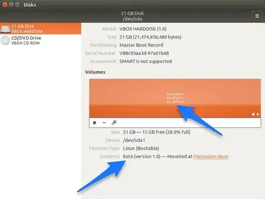

Incidentally, using Disks or Gparted (within Ubuntu) to view the disk and partitions will confirm the FS type. FS location
