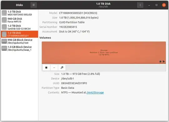

This is what Storage looks like in Disks.

NTFS Read Only
Windows 10 does not fully shutdown the system by default. It uses "Fast Startup" which is another name for hibernate. This puts a "dirty" flag in the NTFS partitions and Ubuntu opens them in the "read only" mode for safety of the partition.
See Unable to mount Windows (NTFS) filesystem due to hibernation for more.
To stop this you will need to disable Fast Startup. The answers in the above link explains how to do this. Here is another page on how to do this.
