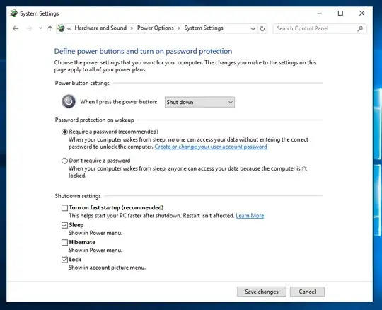

I recently had the same problem and I fixed it. I have dual booted my system in Windows 10 and Ubuntu 15.10. So if you too have a dual boot system, this is how to do it :
  • Boot into windows
  • Search for and open Power options in the Start Menu
  • Click Choose what the power buttons do on the left side of the window
  • Click Change settings that are currently unavailable.
  • Under shutdown settings you will see "Turn on fast startup(recommended)"
  • Disable it and click Save changes.
Screenshot: How to disable fast boot in Windows Done!
  • Now boot back into Ubuntu, you will be able to mount the drive as well as access it with both Windows and Ubuntu
However this will increase the boot time of windows but change is not significant and necessary too if you want dual booted system. It worked for me and I hope, this works in your case too.
