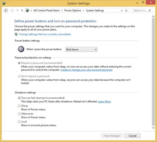

First you should disable fast startup option in Windows 8.1 , which is a feature that speed up windows booting .
As the Picture :
Uncheck Turn on fast startup and try again .
