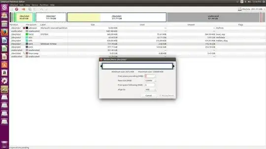

I can't to be able to re-size windows 10 file system partition using Gparted.
The partition is un-mounted and this is not about swap-partitioning
Do help me?

You can not just extend any partition you like. There must be some space at least at one side of the partition. If that is not the case, you need to move other partitions to get this space in the right place.
Important note: If you move the left side of linux or Windows boot partition, the system will not boot. You will need to re-install grub.
