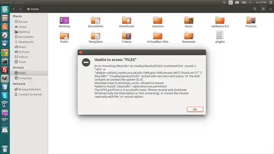

I used my converter to connect my FILES (D:) Hard disk via USB to my Ubuntu laptop (It has nothing to do with windows, windows is in another physical hard disk) and I get this error:

You may be able to get it working still from Ubuntu
Install ntfs-3g with
 sudo apt-get install ntfs-3g.
Then run the ntfsfix command on your NTFS partition.
For example:
ntfsfix /dev/hda6
Make sure to change /dev/hda6 to whatever it actually is.
Once that finishes, try to mount again.
