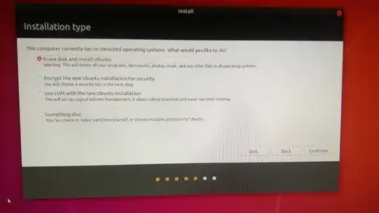

Edit 1 Rather than trying Ubuntu, I went ahead with the install but end up with some bugs...Ubuntu was not able to detect Windows 10 installation on my computer...enter image description here...Seems that 18.04 LTS is somewhat too early to try it out.
