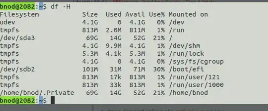

The output for df -H command The output for <code>df -H</code> command

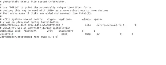

The contents of fstab file The contents of fstab file

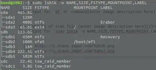

The output for sudo lsblk -o NAME,SIZE,FSTYPE,MOUNTPOINT,LABEL The output for `sudo lsblk
