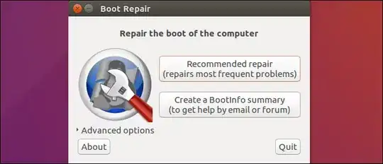

Firstly, please try Grub Repair as detailed here
Boot into a live session. Open a terminal and enter the following commands:
sudo apt-add-repository ppa:yannubuntu/boot-repair
sudo apt-get update
sudo apt-get install -y boot-repair
boot-repair
You should then get this Grub_repair
Boot Repair will begin working. It may ask you to open a Terminal and copy/paste a few commands into it.
Just follow the instructions that appear on your screen. Perform the instructions Boot Repair wants you to and click "Forward" to continue through the wizard. The tool will walk you through everything you need to do.
Restart your computer after the Boot Repair tool finishes applying its changes. Ubuntu should boot up normally.
NB! As always, Windows Fast Start (in your Windows Settings) should be turned off. In the UEFI, secure boot should be turned off and UEFI enabled.
