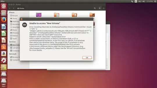

I have a dual boot system with Windows 8.1 and Ubuntu 14.04 but I am not able to open New Volume from Ubuntu. It gives the following error:
error
I disabled the hibernate option using
powercfg /h off
but it did not work although it was able to disable the hibernate and fast boot option.
How can I fix this error?

There might be some problem in your ntfs partition.
You can fix it using ntfsfix
Open terminal and type
  sudo ntfsfix /dev/sda2
After successful completion of command try to remount the portition.
