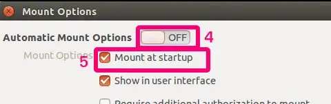

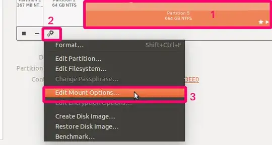

3. tested solution: Type "Disks" in dash and hit enter to open that.
  • Select your partition that you created a link from it(point 1)
  • Click on "More Actions" (gear icon point 2)
  • Select "Edit Mount Options..." (point 3)
this window will open:
  • Drag "On/Off" slider to left side to make it "Off" (point 4)
  • Checked "Mount at startup" check box (point 5)
  • Now click "Close" and also close "Disks" utility.
Test step: Reboot your system and check, you will not see any more that error.
