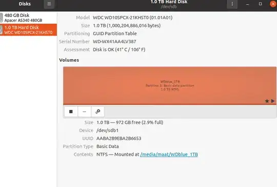

first hard drive has ubuntu partition and windows partition. But mainly I'm using ubuntu.
2nd drive is nearly blank, and has just the single partition with free space.
drive is blank

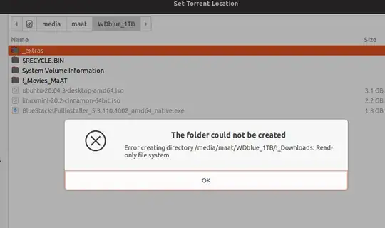

I was trying to move some files to the 2nd drive, but I get an error that it is "read only"

How do I make the 2nd drive writable within ubuntu? I never had these problems in windows or Mac when I have used those laptops. You pop in a drive and it is available to all the user's programs immediately for read/write. At worst, you might have to format it if it is unformatted, or restart computer.
