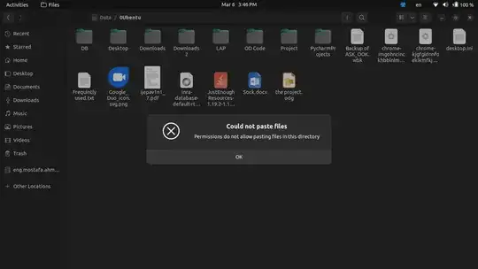

I can't copy files or folders from Ubuntu 22.04 to a Windows partition [D:]
a preview of access denied
As you noticed I was able to do that, but I reinstalled Ubuntu on an SSD instead of HDD, maybe because the first time I made an efi and swap partition when installing Ubuntu the first time. I really don't know what the problem is from, although it wasn't there before. I'm using simple copy/paste shortcuts or the mouse.

It got fixed
Simply Disable the fast StartUp in Windows
simply open windows CMD as an Administrator and write:
powercfg /h off
This will simply turn off the fast StartUp and fix the issue
