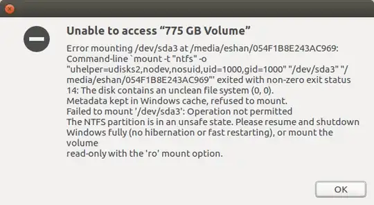

I am using Ubuntu 16.04 and windows 10. When I try to open my other partition (NTFS), sometimes I can open it. But sometimes I can't open it. It shows this error message:
I asked this question in this site. (I can't open other partition in my PC) And I followed that solutions. it did not work.
After that I followed other solution. (Unable to mount Windows (NTFS) filesystem due to hibernation) But I can't understand those solution.
How do I fix my pc?
You have to boot into Windows, disable fastboot and do a prober shutdown. Then boot into Ubuntu again, and you will be able to mount the NTFS partiton.
Exactly at the error message says.
