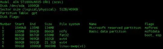

  2. When I boot into Ubuntu, it can't seem to find my SSD. It can only detect the hard drive that has Ubuntu installed on it. I have also attached a screenshot of what I get when I type the following command in terminal:
    sudo parted -l
    Its output is:
    Command Output
Is there a way I can access my SSD from Linux and boot into Windows from GRUB or do I have to open BIOS every time I start my computer and choose where I want to boot?
