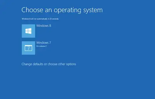

  1. Will GRUB replace my Windows 8 bootloader?
    Choose an operating system

  1. Grub will replace your boot-loader and it will look like a standard Linux GRUB menu. You can however make Linux OR Windows as your default after successfully installing Linux.
  2. Let Ubuntu installer handle partitioning. You do not need to create partitions manually before installation. Ubuntu installer will provide visual tool where you simply slide and adjust the space desired to Linux and Windows. The gui partition tool/installer will handle the rest and update GRUB boot menu. You can not have the Windows boot-loader BUT it will boot to both OS just fine.
