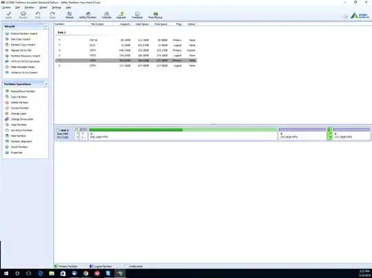

I have a 1TB of harddrive on which windows 10 is installed. I previously had Ubuntu installed on the system but deleted it as I wanted to install the 14.04. I deleted the partition from Windows 10.
When I am trying to install using the live CD, I can only see the disk as a single drive and not seeing all the partitions. I am not sure what is wrong. Is it something related to my partitioning?
See the attached partition table
I need to use the J drive to install ubuntu 14.04 and I drive for 16.04.

  • Gparted is showing the disk with unallocated sign. [Attached picture]
  • I merged one of the drives with the C drive. The left unused empty drive is NTFS with about 115 GB on which I wish to install Ubuntu 14.04.

These are the steps I followed to solve the problem.
  1. I used AOMEI partition manager (free version) on the Windows side to merge all the secondary partitions to the main C drive.
  2. As mentioned by @AlexP, some sectors of the drive were overlapping and not in order. I used the AOMEI partition manager again to reorder the drives such that the sectors were properly ordered. This process took time as GB's of data in my primary drive had to be moved. (2.5 hrs.).
  3. After this I was able to reboot into the Windows side. AOMEI also corrected any boot errors along the way, so I just had to sit and wait.
  4. When installing a fresh copy of Ubuntu the drives showed up correctly and I was able to install Ubuntu using the Something else option.
