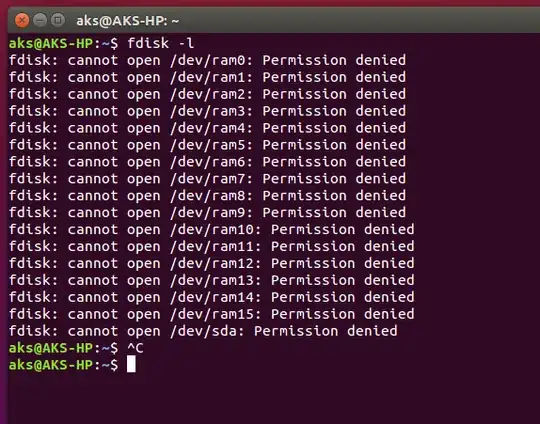

I DID TYPE fdisk -l in terminal and it shows: Terminal
Please tell me a breif descriptions with Codes(if necessary), to access files on Windows. Or to make access to Windows via boot. It is too much necessary as my Very important documents are in Windows and I can't access them.
