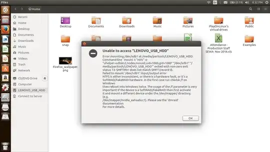

This is my first day on Ubuntu. My computer comes with preloaded Ubuntu. When connected to my external Hard Drive, I got this message. My understanding is that it says Ubuntu is not able to mount my hard drive and gives the following error.
Please help me understand this thing.

Windows file system looks dirty to Ubuntu. This is because Windows uses a hibernation file to save the system state.
You'll need to do this in Windows:
  • open the Power control panel
  • click on change what the power buttons do
  • click on change options that are unavailable
  • uncheck fast start
  • close the Power control panel
  • open an administrative command prompt window
  • type powercfg /h off (turns off hibernation)
  • type chkdsk /f c: (change c: to the correct drive letter, if required)
  • approve that chkdsk runs at next boot time
  • reboot Windows
Now you should be able to boot Ubuntu, and attach the drive successfully.
