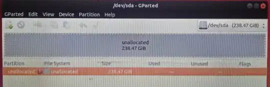

Under Disks it is showing SSD as (dev/sda) but against Partition (No Content)
Using Gparted it is showing unallocated all the disk space (I can't see the partitions, root or others
screenshot of gparted
sudo fdisk -l Ubuntu installed under /dev/sda
Still not showing devices/ partitions related to the sda (SSD in which Ubuntu Installed)
