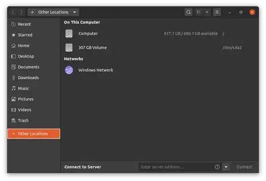

Please open "files" app (by default in ubuntu). Then click on " + Other Locations ". There you'll be able to see your windows partition as shown in the image. enter image description here
In the image, "307 GB Volume -- /dev/sda2" is my unmounted Windows partition. Clicking on which, it will get mounted and you'll be able to access it on nautilus.
