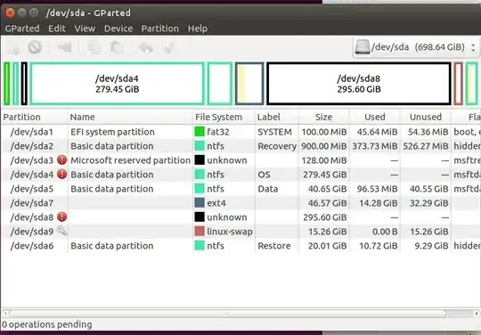

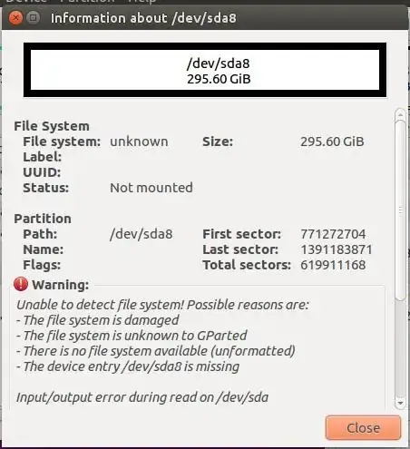

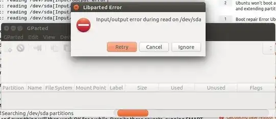

Ran gparted as suggested above. Got the following error:
Gparted I/O problem
SrartDatafail
Update 4:
Ran gparted again. Results:
Ran gparted again - results

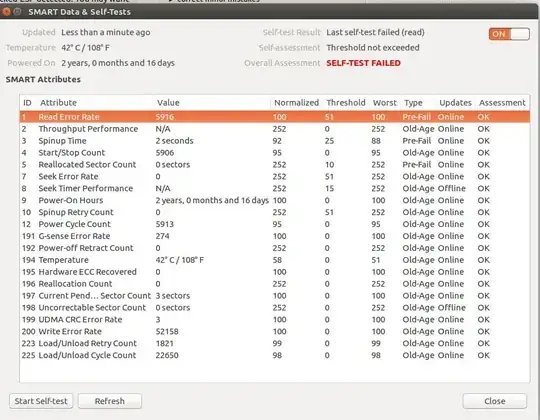

Update 5:
Update 6:

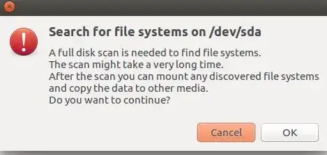

Should I run Gparted data rescue?

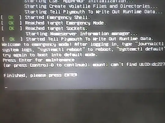

Message during startup:
message during startup

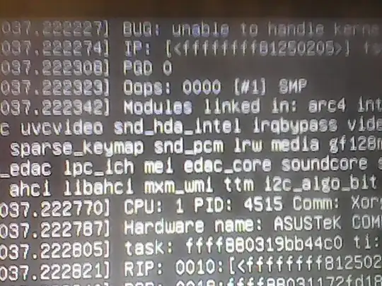

unable to handle kernel - crash during while running off of USB:
close-up of kernel message:

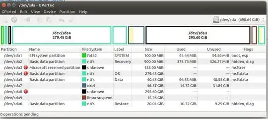

Update (1.12.2018):

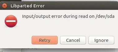

gparted screenshot
gparted screenshot
This came up a few time before finishing gparted report:
Gparted error on sda3, system reserved is normal as that is required to be unformatted, but then gparted throws an error. The error on sda4 is only normal if you can directly boot Windows and then that says your have fast startup still on. But error on ext4 partition, sda8, says you may need fsck.Run both of these commands on sda8. Ubuntu 14.04 is not booting normaly after a manual hard boot
