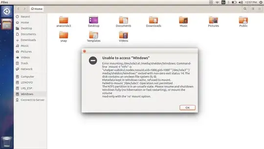

Somehow I cannot access my windows folder. It worked fine for the last couple of months. This is the first time this happened.

Start the windows OS again and cleanly shutdown or restart the laptop from there. Then check from the ubuntu. Your problem should be fixed.
The problem could be, that fast boot enabled is enabled in Windows. So Windows dos not unmount the partitions when shutdown process but on restart it will.
