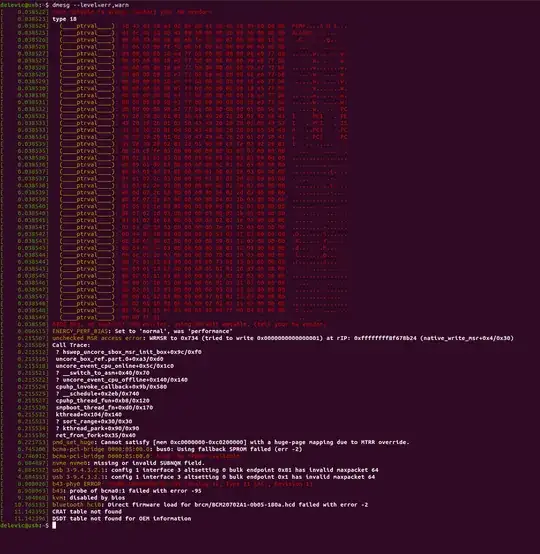

I can't install Ubuntu or start Ubuntu live on my PC. I have a (ca. 2014) Asus Rampage V motherboard and an Intel i7-5960x CPU. When I want to start Ubuntu from a LiveUSB on this six year old design, I got this message :
Screen pic of boot failure

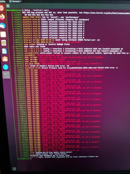

I manage somhow to enter in Live 20.04 and get dmesg:

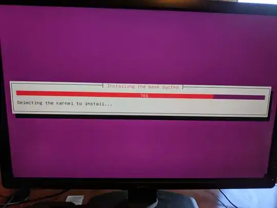

When I tried to install system from Ubuntu Minimal (mini.iso), installtion stuck on 78% Selecting the kernel to install.... enter image description here

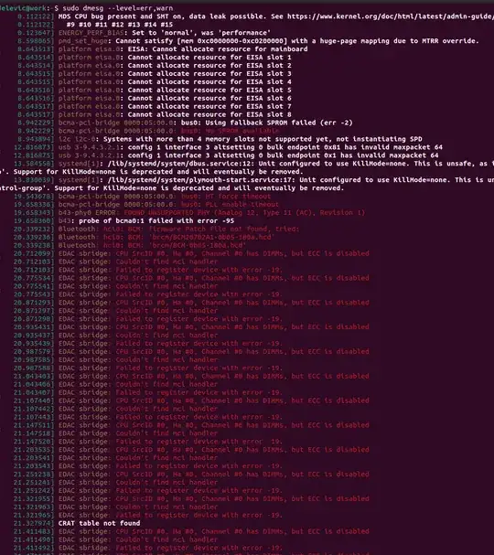

I manage to boot with kernel option "acpi=off noapic"
and only one core works...

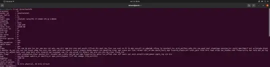

I just installed 20.10 beta. And it works :) dmesg errors are the same , but it works. enter image description here enter image description here
All cores are active without modification :)
It looks like that developers read this post! Thanks!!
