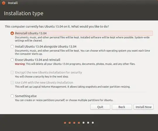

If you would like to start over, then a fresh installation would be suffice. All you have to do is to download Ubuntu (if you don't have it already). After that, you can create a Live USB on your Mac. Then, boot up the OS on the Lenovo PC and you will get to a screen like this:
Reinstall image
Of course, the version of Ubuntu will be particular to the one you downloaded. You have four options, but you want is the third option(from the top).
From there, follow the instructions, and you should have Ubuntu up and running in the next 5-10 minutes!
