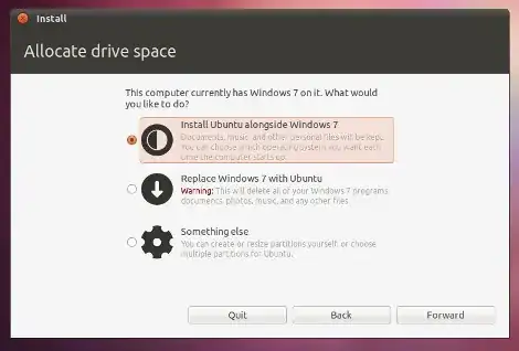

You do not need to prepare a partition in advance of installing Ubuntu alongside Windows with dual-boot. Ubuntu's installer has a very easy to understand installer that will guide you through the process. It's as easy as this:
  1. The Ubuntu installer asks whether to install Ubuntu alongside Windows (dual-boot), or to replace Windows completely. Choose the first option.
    Installer screenshot

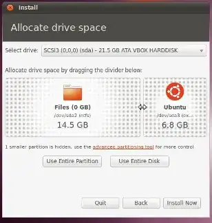

  2. You can choose how much space you want to give to Ubuntu by dragging and dropping the slider in the next step of the process:
Full instructions are found in the answers to this question: How can I dual boot Windows and Ubuntu?
