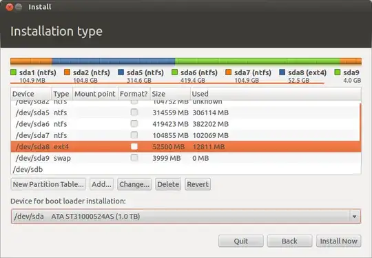

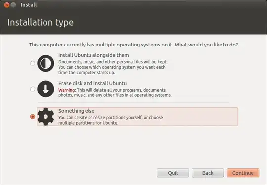

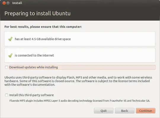

I am not very familiar with all the process of installing Ubuntu and the how-it-works, but one of my friends had shown me how to install Ubuntu 10.something on a partition (I have Windows 7 on the other one) and it worked nicely, and since then I've been using Ubuntu. The upgrade from 10 to 11 went just fine, but when going from 11 to 12.04, my computer crashed in the middle (I don't remember why). But now I have Ubuntu 12.04 and I constantly have this red disk with a white dash in it on my desktop bar reminding me that I have a System Problem. I believe re-installing Ubuntu 12.04 (if my computer doesn't crash during the installation this time) would work, but I don't know how to do this. So here is the question :
How would I re-install Ubuntu 12.04? Is there a guide out there for this?

Then make sure you have Internet Connection ,don't select anything & Continue
Then At this Below image Menu select the Last option ( Other options Might Vary to that of yours) Something Else ,& continue.
You will be brought to Partition table , Most important step also,
Select the Partition Your current Ubuntu installation is On , most probably will be with ext4 ( or ext3 ) type and verify its size if you know it , if you can't recognize then Open the Dash and search for Disk Utility & maximize it, select your hard drive , and search & select the ext4 or ext3 partition , you will find its appropriate /dev/sdaX number , now Back in Installation menu , Tick mark the Square Box to Format it , & select the Mount Point as / only ,stating root partition.
Since you are re-installing, so i am assuming that you already have swap partition present as from below image.
Don't click Install now yet , see the Device for boot loader installation option , preferably select /dev/sda without any number adjoining it.
Now you can Cross-check the partition and booting option , and Select Install now to go forward. Further options are pretty simple , they don't need instructions.

Your're right, reinstalling sounds like a good idea in your case. I'd suggest you checked out the Ubuntu Manual. You can download it here and it covers the installation process in depth starting in chapter 2 (I believe). Good luck!

Agreed, reinstalling sounds like the best option, here is a guide as requested :
First boot the live cd and select try ubuntu.
When it has loaded open disk utility and click on your hard disk,
then click on the partition you want to install to (you should recognise it by the size or ext file system),
just below you should see device followed by something like /dev/sda2
and so sda2 would be the partition to install to.
Next click the install ubuntu icon on the desktop,
select the bottom option something else.
You will then be able to select which partition to install to,
which will be called sda2 (or whatever you saw earlier in disc utility).
Click on that partition and select change then select format as ext4 and give it a mount point of /.
Finally click install at the bottom.
