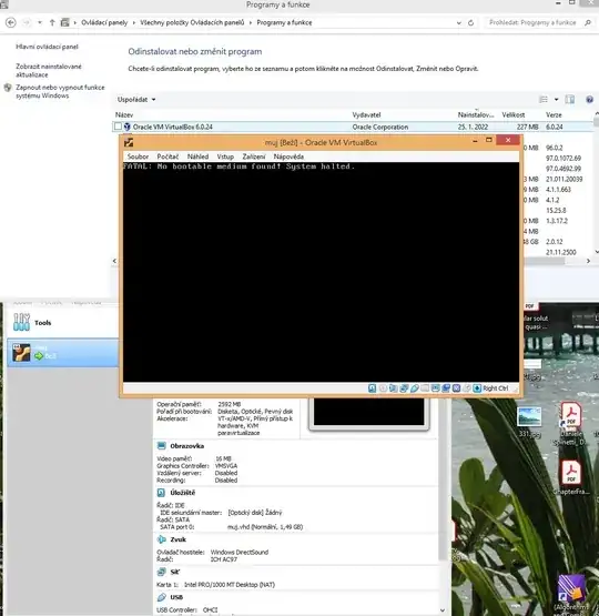

I have installed VM on my Windows 8, but FATAL error has occurred . How can I fix it, what's wrong?
Error404
  • 8,278
  • 35
  • 60
As @user535733 has mentioned, you've likely not loaded the installation ISO file. Looking at the screenshots, it looks like you may have several issues that will need to be resolved before you can install Ubuntu:
  1. the system memory is insufficient for Ubuntu Desktop (but okay for Ubuntu Server)
  2. the video memory is insufficient for Ubuntu Desktop (but okay for Ubuntu Server)
  3. the storage space (1.49 GB) is insufficient for any modern version of Linux
  4. the network adapter may be better set as "Bridged"

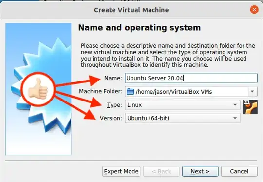

  3. Give the VM a descriptive name and ensure it is set to "Linux" and "Ubuntu (64-bit)": Check the settings

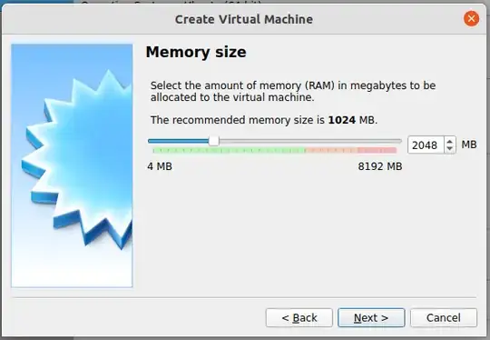

  4. Give the VM at least 2GB of RAM. Ubuntu Server can run with less, but 2GB is a good start: Set the Memory
    You can always change this later if needs be.

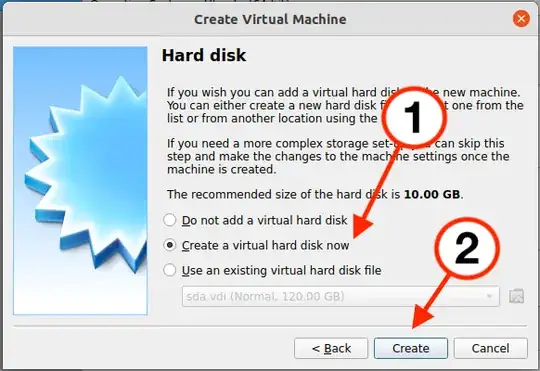

  5. For the storage, choose "Create a virtual hard disk now" and press "Create": Make some storage

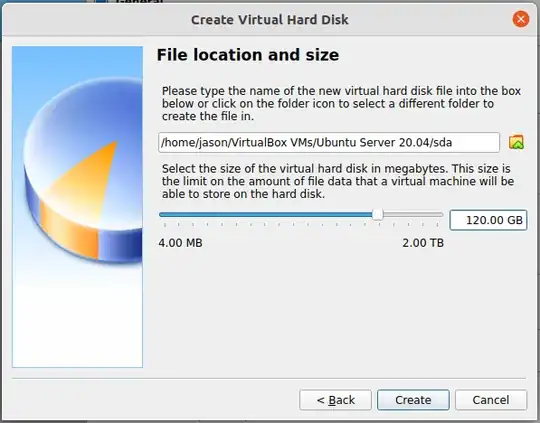

  7. Set the amount of storage to a number greater than 25GB: File location and size
    Note: Because the disk image is dynamic, it will not use all this space immediately. It is simply a maximum.

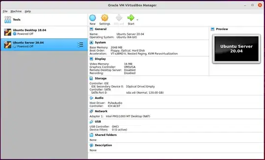

VirtualBox Overview

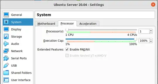

  1. Press the "Settings" icon (with the gear) and choose "System" from the left-side menu. Set the "Processor" to a good number of CPUs, with 2 being good number for a simple VM: Processor
    Checking "Enable PAE/NX" may be worthwhile, but not a requirement.

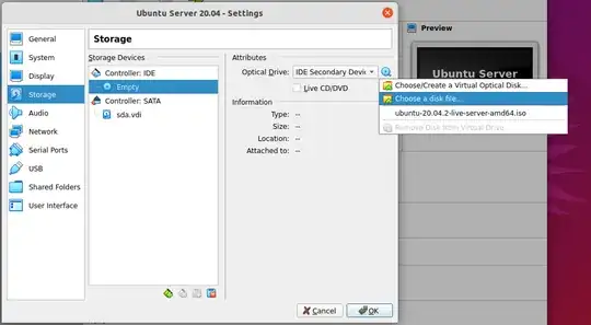

  2. Under Storage, mount the Ubuntu 20.04 ISO that you downloaded to the CD: Mount CD
    You will need to use the .iso file, not a flash disk with the ISO "burned" to it. If you don't have the ISO, you can download one from Ubuntu.
    Ensure "Live CD/DVD" is checked: Live CD

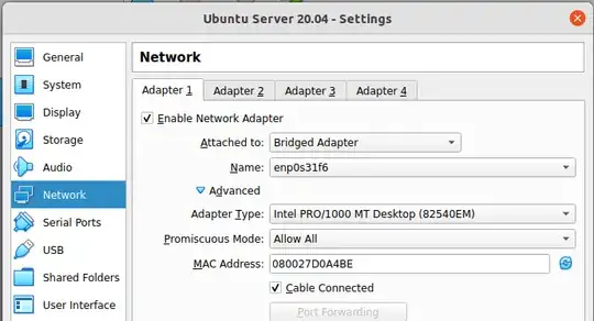

  4. Under Network, select "Bridged Adapter" so that the VM connects to your network. Click "Advanced", then choose "Allow All" under the "Promiscuous Mode" setting. This will make it easier for you to use the VM like a normal server on your network: Network Settings

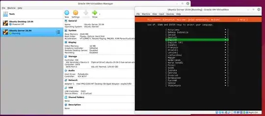

Now that the basic settings are done, you're ready to press "Start" and install Ubuntu Server:
Install Ubuntu Server
