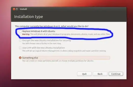

Yes, this is totally possible. Boot from an Ubuntu Live DVD or Live USB. Go through the steps to install Ubuntu. When you see this step, select the top option like so:
Please note that by doing this, you will make it impossible or very difficult to retrieve any of the data (personal files, etc.) currently stored on this HDD. But you say in OP that this is what you want.

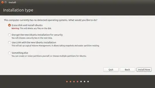

Depending on how hosed up your Windows installation is, you may also see something like this. Regardless, the choice is the same.
