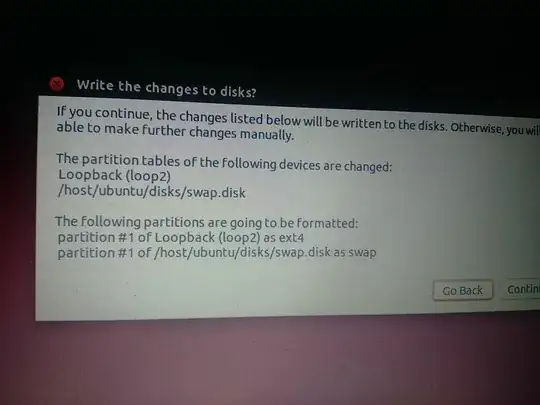

I'm very new to Ubuntu, I used the Windows installer to install it aside with Windows 7. I chose the same partition as it has enough space. I got this message when the computer rebooted and I'm afraid if I press continue, any data would be lost. I don't actually know much about the "Loopback" and "swap".
What should I do?

You should STOP !
Installing Ubuntu via wubi is not recommended.
Download the Ubuntu desktop installation image.
Burn this ISO file to a DVD or create an USB media.
Boot from the installation media and install Ubuntu.
Read about all details in the Ubuntu installation guide.
To create an USB media from within Windows properly,
open command prompt as administrator and execute:
diskpart
list disk
select disk *
clean
create partition primary
active
format fs=fat32 (quick)
assign letter=**
Note : * = number of the USB drive | ** = select a free drive letter
Mount the Ubuntu ISO file and copy all the content to the USB drive.
