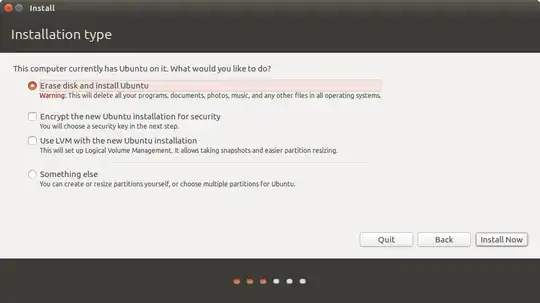

You don't need a custom installation to reinstall Ubuntu. The Ubuntu installer has an option to Erase disk and install Ubuntu that you can simply click instead of doing a more complicated custom installation.
  1. Backup your personal files from your existing Ubuntu installation.
  2. Create an Ubuntu live DVD or USB to use as installation media.
  3. Boot from the Ubuntu live DVD or USB, start the Ubuntu installer, and in the Installation type screen select Erase disk and install Ubuntu.
