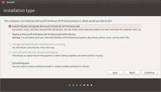

If you want ubuntu in dual boot you should create a partition but if you want to replace windows XP you dont need to create a partition. If you want to install inside windows you dont need to do anything.

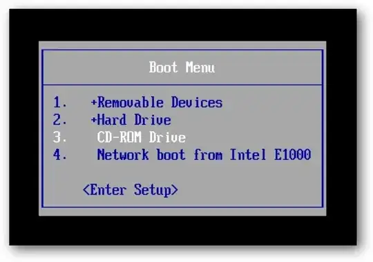

After that, turn off your computer and insert Ubuntu disc you've burnt. Enter boot menu in your laptop and select CD-ROM Drive.
Your laptop should be booting to Ubuntu now. From there, you can try Ubuntu, or install it. You don't have to worry about creating partitions etc. as Ubuntu installer will ask you, what to do.
