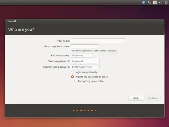

I just put Ubuntu 15.04 on a flash drive using pendrivelinux, and when attempting to install it on my computer, it asks for a username and password. What is the default username and password? I haven't been able to find it anywhere on the web. Thanks!
If it looks like this:
It's asking you to chose your own password. Go for one at lwast 10 characters, (12 is better) that you don't use elsewhere, and has a mix of uppercase (A-Z), lowercase (a-z), numbers (0-9) and punctuation (!"£$%^&*()-=_+{}[]:@~;'#<>?,./¬|\).

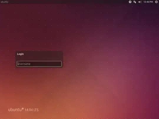

The username is ubuntu and there is no password (just press enter when it asks).
