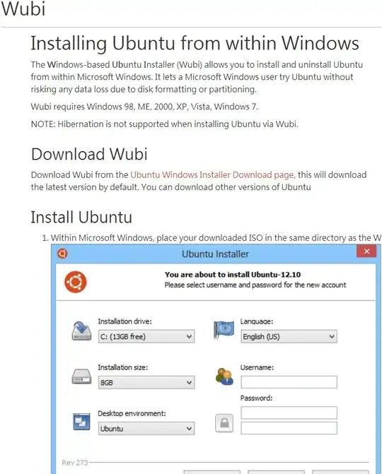

I recommend Wubi, because you can "try out" Ubuntu without actually changing partition, or even create boot USB/DVD. It's a Windows program that let you download Ubuntu installation ISO, and then it walks you through baby steps.
