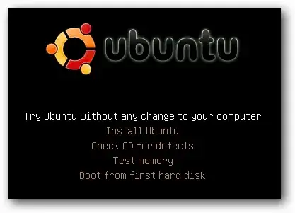

If you are able to boot this Live System, you should get a screen like this: BIOS mode

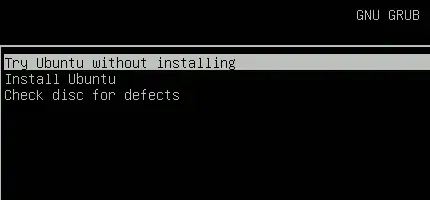

or this:
EFI mode
Now select Try Ubuntu and wait until you get to the desktop. You can play a bit to see whether you like it or not and can click Install on the desktop to install Ubuntu. The installation offers you to replace XP, to install it alongside XP or to configure everything yourself. From your question I guess that you'd like to replace XP. So select it and let the installation Wizard do the rest.
