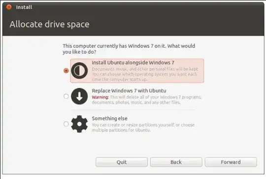

You can just make some free space for ubuntu in windows and start installing ubuntu.
During the installation select install ubuntu alongside windows
enter image description here Ubuntu will be installed in the free space created.

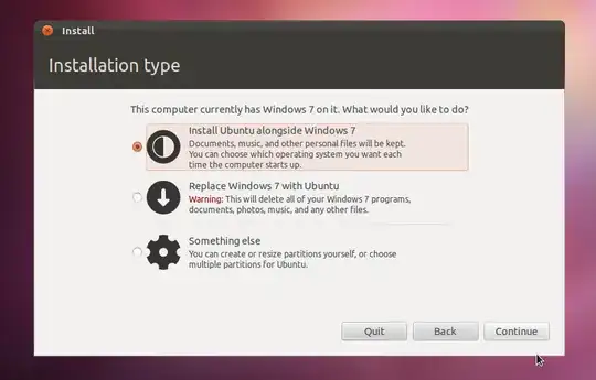

at the time of installing Ubuntu in your PC you will come across the following step of selecting partition enter image description here
Then in that step choose Option No:3 i.e, Something else. After that click at continue then you will be continued to

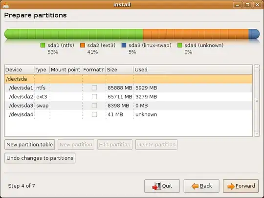

In this step you can find your partition which you have already given for Ubuntu installation. select it place the mount point as / and type as ext4 and then allocate it be maximum.
hope that helps.
